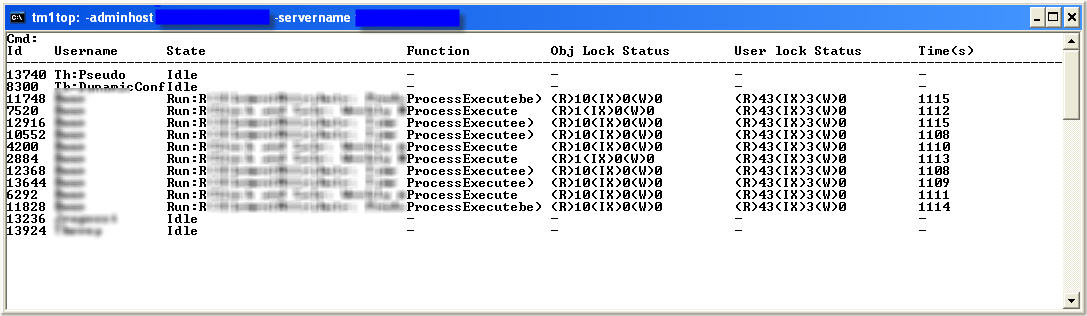

PlanningDev wrote:I then have 2 processes to pull data from the same ODBC source, into the cubes. Cube logging is not checked here. There are two chores each with one of the processes. I run TM1ChoreExecute in the eplilog of a process to execute both chores at the same time and one of them is still going into wait.
It looks as if you try to execute 2 TI processes in parallel by 1 user thread. This will not work. Every TI process you intend to run in parallel must be executed by it's own user thread.
Try that:
- Start the TM1Top tool to monitor user thread activity.
- Start the first TM1 Architect session, thus starting the first user thread.
- Start the second TM1 Architect session, thus starting the second user thread.
- Simultaneously, in the first TM1 Architect session start the first TI process, and in the second TM1 Architect session start the second TI process.
- The TM1Top tool should display both user threads in a run state, both accumulating CPU time.

Re: parallel 2 TI process
Using TM1ProcessExecute.exe for parallel loads is relatively simple and not that messy, it just requires a separate bat file for each parallel thread. If you keep everything within TM1 by calling the batch files with ExecuteCommand with no wait then I would say it is not messy at all. -You just need to ensure that TIProcessExecute logs on with a separate user than the calling shell process to avoid any possibility of deadlock, and unless you want to parametize the client and password in the bat file and pass it in through the TI then it is also a good idea from a compliance perspective to make sure the batch files are somewhere nice and safe.
If an external enterprise scheduling tool like Control-M or Tivoli is used to trigger the batch files then yes it can get messy but this needs to be weighed up against the benefits of external triggering of loads versus relying on the chore scheduler which as we all know is quite limited.
