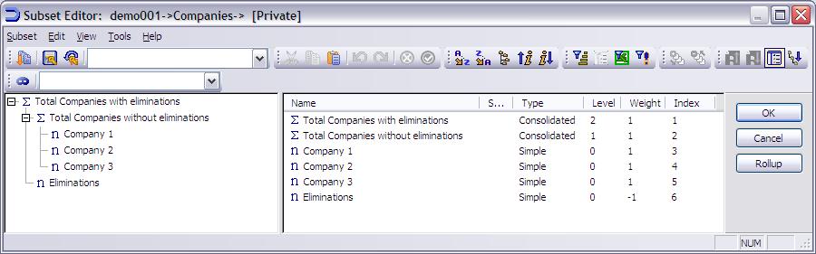

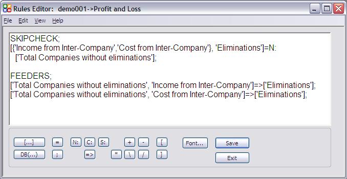

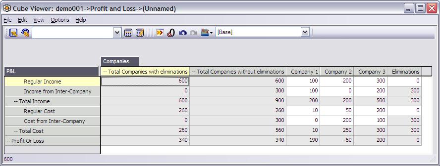

I also think you ment Intra-Company and prepared a quick demo for you:
The case here is, you have 3 companies. Every company has its own income and costs, so has its own profit/loss. But some of income/costs are inter-company, so when you want to analyze the total for companies and want to eliminate inter-company influence you can do it this way:
1. Build Company dimension like the one in "01. Companies subset.JPG" (note the -1 weight on "Eliminations" element).
2. Write rules like the ones in "03. Rules for eliminations.JPG" (Rules tell TM1 to "copy" the value from "Total Companies without eliminations" to "Eliminations" element for the lines that should be eliminated on the "Total Companies with eliminations" element).
On the view "02. View with eliminations.JPG" you can see the result. Every company has its own P&L, you can analyze P&L for all companies both with and without eliminations.
