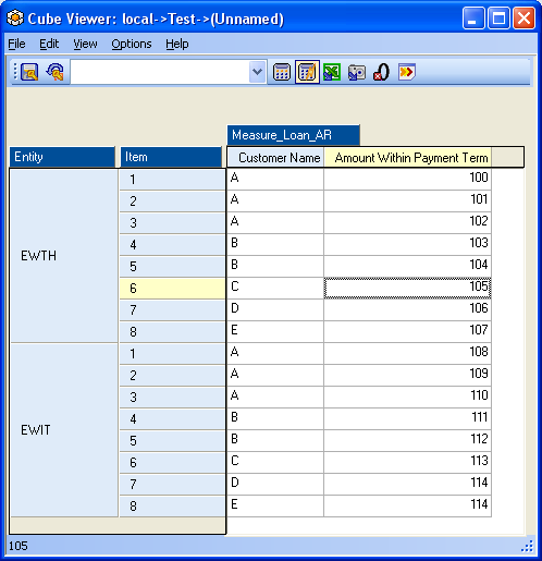

What i expect is
This is a result that i expect

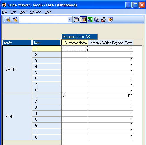

but my result appear as follow

Assuming that the code you posted is the exact code then you have a mis-spelling
Curententity = Entity;
Instead of
CurrentEntity = Entity ;
Which probably means that your breaks aren't working

by anote
Thank you for your kindly help
Your code works very well
my mistake that I make a wrong type
