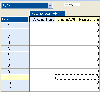

Re: How can I create TI Script with intangible element?
Many thank David/Steve for your reply
My expect view is follow attach file
But in my ERP doesn't has item column.
ERP has only Company, Customer name, Amount
My purpose is not to use OLAP cube as relational table but i need to have item dimension to serve report view
Can it possible to use TI to load data from ERP? please give me a suggestion

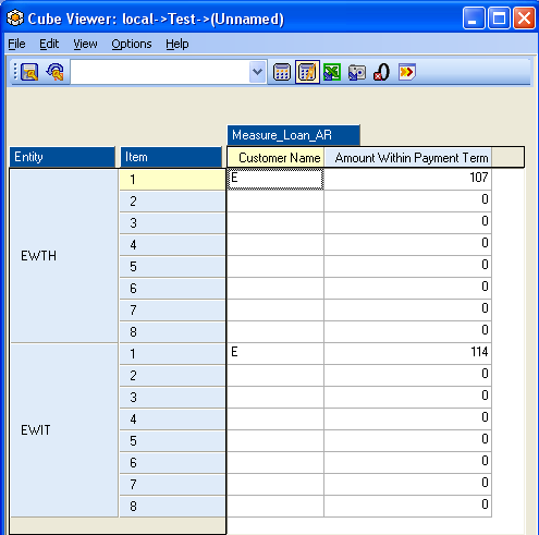

I do follow your suggestion
prolog tab
ItemCount=0;
CurrentEntity='';
Data tab
if( Entity @= CurrentEntity );
ItemCount=ItemCount+1;
Else;
Curententity = Entity;
ItemCount = 1;
Endif;
item=numbertostring(itemcount);
CellputS(V2,'test',Entity,item,'Customer Name');
CellputN(V3,'test',Entity,item,'Amount Within Payment Term');
What i expect is
but my result appear as follow
prolog tab
ItemCount=0;
CurrentEntity='';
Data tab
Else;
ItemCount = 1;
Endif;
What i expect is
Thank you for your kindly help
Your code works very well
my mistake that I make a wrong type
