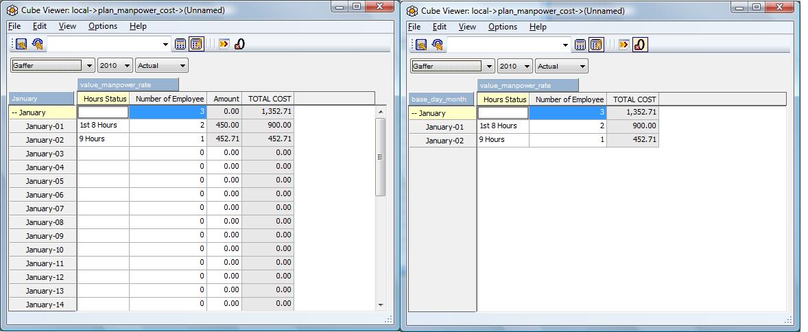

I'd like to ask why values dervied using IF statement where the value being compared is a string?
This is the rules I got for the IF statement:

This it a lack of feeder issue.
You can see it from the 'Amount' of January.
It is 0 on your screenshot and you have only N level rules for the Amount dimension element.
