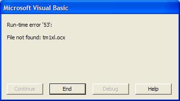

After finally conceding (based on researching prior posts) that the only reliable way to install TM1 Perspectives was to do so with Administrator rights, I had our package people build and install Perspectives with administrator privileges.
Apparently, it’s a known issue that TM1 must register some .dll and .ocx files during installation and these will fail without admin privileges. Before trying Perspectives after it was administratively installed, I was encouraged to see that indeed the following objects were successfully registered:
C:\Program Files\Cognos\TM1\bin\tm1prc.dll
C:\Program Files\Cognos\TM1\bin\tm1xl.ocx
C:\Program Files\Cognos\TM1\bin\TM1RuleEditor.dll
C:\Program Files\Cognos\TM1\bin\ExcelServiceCom.dll
Unfortunately, the result was the same with a “Run-time error: 53: File not found: tm1xl.ocx†Excel error when launching Perspectives.
See the attached .xls file for more specifics on the registration properties of these files.
The package installed MR1_X32 first and then FP002_X32. I'm running Excel 2007. I've got a week to figure this out before we're supposed to deploy to numerous end users.
Thoughts? Incantations???
Thanks. -- John

Re: At Wits' End: "File not found: tm1xl.ocx"
John
If you are still having problems, come back to me, but from memory I think that the file that you are missing is
tm1dasrv.dll
You need three files registered for the tm1xl.ocx to work (This is the In-Spreadsheet Browser by the way)
tm1dasrv.dll
tm1prc.dll
tm1xl.ocx
To register them, drag when on to regsvr32.exe in C:\Windows\System32.
You need local admin rights on the machine for this.
I am assuming that your machines are locked down so that only your IT Dept have local admin rights. The other alternative would be to ask them to login, uninstall TM1 and re-install it. As you have probably learnt by now, just about any bit of software will need local admin rights before it can be installed, so it is probably best to wait for the IT Dept to package the application properly, and make sure you test it before you sign off the package.
Paul Simon
tm1dasrv.dll
tm1dasrv.dll
tm1prc.dll
tm1xl.ocx
Paul Simon
Paul --
My install was in fact missing the tm1dasrv.dll binary altogether... I copied over the file from the server which has a functioning perspectives and registered it but got the same error message. Unfortunately, this was all the time I had today to work on this issue. It's still a front-burner problem though and it sounds like you may be on to something. Hopefully tomorrow the package guys will get around to trying an administrative install on a "virgin" laptop that hasn't already been subjected to multiple attempted perspective installations like mine has.
Anyhow, thanks again for your insights.
-- John
-- John
Thought I'd share the conclusion to three weeks of investigation...
The tm1xl.ocx error turns out to have been caused by a failure to load ssleay32.dll in the tm1p.xla VB code. There are several dll's that tm1p.xla tries to load before tm1xl.ocx. However, tm1p doesn't complain if any of these precursor dll's fail even though tm1xl.ocx is dependent upon them.
Ssleay32.dll is part of the open source OpenSSH package which Cognos is utilizing. Although this dll was properly installed, it appears to have been in conflict with some highly-privileged (system "owned" backed by a specialized group policy), custom (googling the .exe names returns nada), big brother monitoring package mandated by our IT group. This package also loads it's own ssleay32.dll. The fix was to replace TM1's bin/ssleay32.dll and bin/libeay32.dll with the dll's utilized by the monitoring package.
-- John
-- John

Hello, I am getting Tm1.ocx error 53.
I tried registering all the DLLs (tm1xl.ocx, tm1prc.dll,tm1dasrv.dll ) but still getting error. I checked the path of tm1.xla from VBA and its pointing to
C:\Program Files\ibm\cognos\tm1_64\bin64
I believe path to tm1p.xla should point to 'C:\Program Files\ibm\cognos\tm1_64\bin' folder since my MS Excel is 32 bit. If that's true, how do I change the TM1 perspective to look at 'C:\Program Files\ibm\cognos\tm1_64\bin64' folder for Tm1p.xla
Thnx
Rtel
Thnx

Correction..
I believe path to tm1p.xla should point to 'C:\Program Files\ibm\cognos\tm1_64\bin' folder since my MS Excel is 32 bit. If that's true, how do I change the TM1 perspective to look at 'C:\Program Files\ibm\cognos\tm1_64\bin' folder for Tm1p.xla
You can point the shortcut to the correct file in the correct folder.
