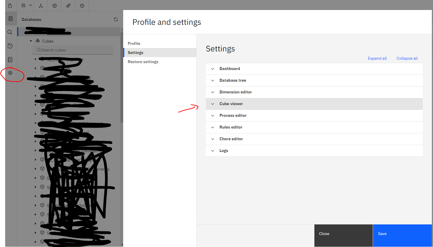

1. At least in IBM PAoC, Planning Analytics on Cloud, you can set and save settings for various areas. See the screenshot of the workbench with the options on the left hand side.
