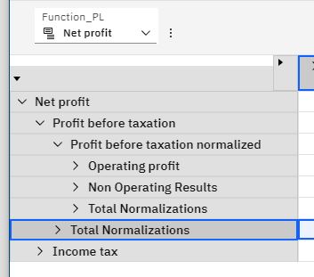

Hi, is there a possiblity to fixate the row/column header in a cube view in PAfE?
As soon as I drill in the hierarchies in my row or columns, the column width always jumps back to a small size which does not show the whole text of the elements.
Example:
In this view I adjusted the first column so that I can read the whole text:
If I now close or open a node within my hierarchy, e.g. close the node Profit before taxation normalized, the column is automatically adjusted so that I can no longer read the whole text.
In this view the first column is now automatically adjusted and I can no longer read the whole text:
Is there a possiblity to avoid this auto adjustment of this column?

Do you get the same behaviour with the view if you open in PAW using a workbench?
And if you open the view in a Book it retains the column widths?
If so, please also log a defect as I have raised this too as it seemed to come in with a recent update (possibly new formatter) and is extremely annoying.
BR, George.

I just tried in PAW and its indeed as gtonkin says.
View used in a book works fine but in a workbench I see the same behaviour.
We will log a defect at IBM.
