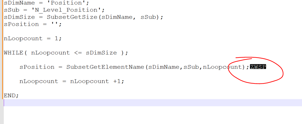

Re: SubsetGetElementName loop
When I paste the first code in Notepad++ I see this, maybe it's the cause:

Hi Wim,
Many thanks, this was the issue. No idea where that came from!
I thought I had deleted everything between the loop but obviously missed that little bit.
Must have been something copied from the cubewise page.
