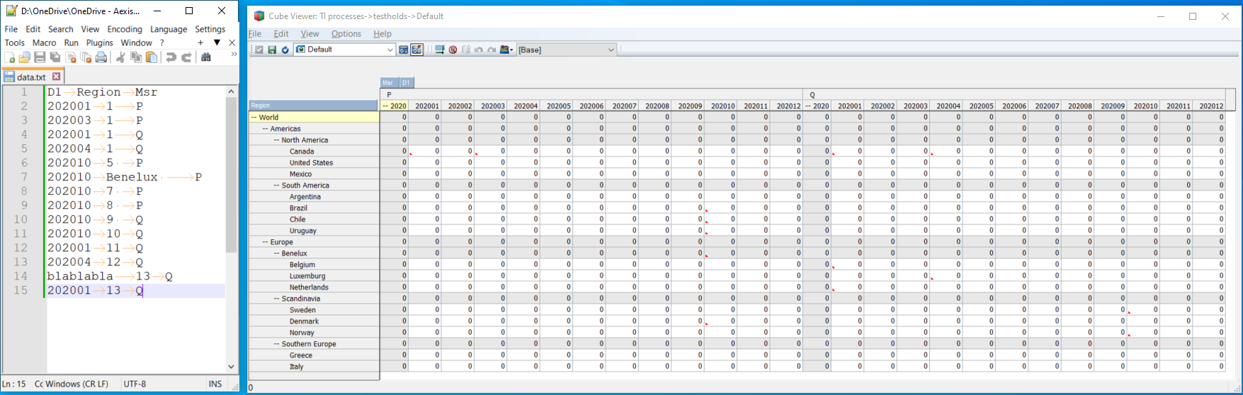

Here is a TI approach. The process will read a text file and apply holds to the given combinations.
In the example it will lead to 13 holds in the cube, as the combination in line 14 cannot be located in the cube.
It gives us 13 holds (red triangles) at several levels in the cube.
