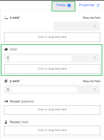

You need "Color" section in "Fields" tab for this.
Image 4.png (16.99 KiB) Viewed 2682 times

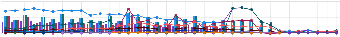

You should use the "couleur" fields. One of them is for columns, one is for lines (my French is too bad)
Image 4.png (53.21 KiB) Viewed 2654 times

I've dragged random dimensions (Version and Cost center) to colors just to show how it works.
This depends on what you want to be split to different lines and different columns. Note that This should be different dimensions
