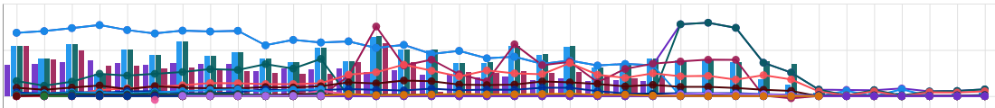

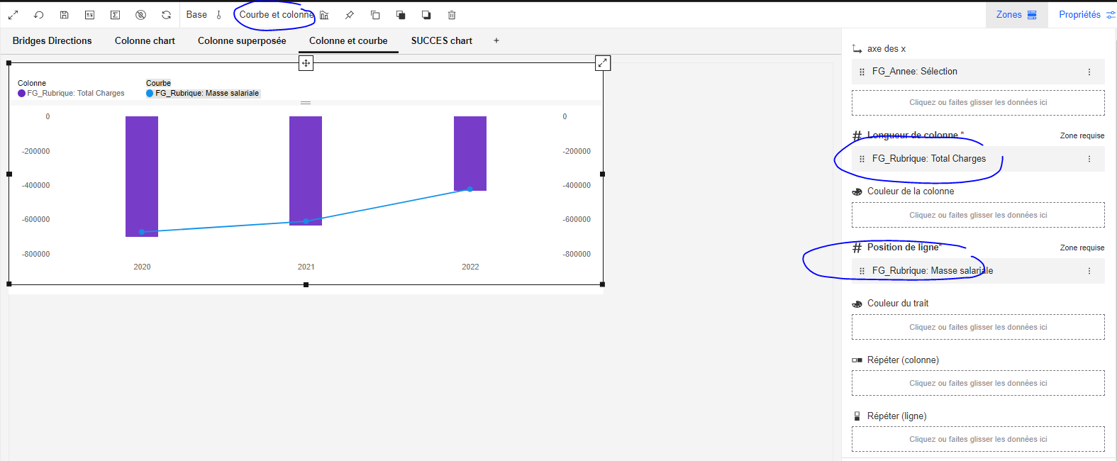

Elessar wrote: Mon Oct 03, 2022 3:08 pm Hi,
You need "Color" section in "Fields" tab for this.
thanks you for your reponse. it work well with "line" charts
but when iam in "colum and line" charts, i can only put 1 line in this field (photo before change and photo after change)
thank
colum and line chart question - after change.PNG (57.16 KiB) Viewed 2671 times
colum and line chart question - before change.png (50.62 KiB) Viewed 2671 times
Elessar
Posts: 414
OLAP Product: PA 2
Version: 2.0.9
Re: Colum and line charts question - PAW - Multi line
Post by Elessar »
You should use the "couleur" fields. One of them is for columns, one is for lines (my French is too bad)

mrdauduong
Posts: 52
Joined: Mon Sep 26, 2022 11:10 am
Version: PA 2.0.74.23
Excel Version: Excel 2016
Post by mrdauduong »
thank Elessar the for the fast repose.
Can you show me what you put in the "couleur" fields?
My probleme is my colum and my line came from the same dimension FG_account
with colum is total account and line is the detail of account
i can not do something to make it work.
thank a lot for your help!

Elessar
Posts: 414
OLAP Product: PA 2
Version: 2.0.9
Post by Elessar »
I've dragged random dimensions (Version and Cost center) to colors just to show how it works.
This depends on what you want to be split to different lines and different columns. Note that This should be different dimensions
