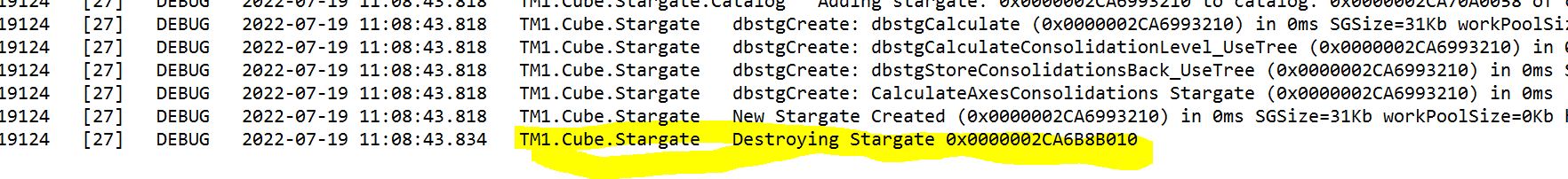

I tried to use Stargate View for a large cube for the first time but couldn't create it. I debugged it also from tm1s-log.properties and I am getting information about it like at the bottom:

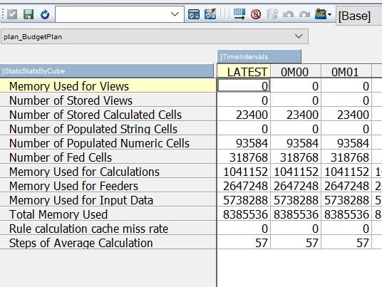

After a new stargate is created, it destroys it a couple of minutes later. Also, I am not able to see information like the Number of Stored Views or Memory Used For Views in the }StatsbyCube cube.

I tried to create Stargate View on my local computer on the Planing Sample instance which is an IBM sample database. I had the same error.
My Pa version is 11.8.100.13
I used the "plan_BudgetPlan" cube and created a view with all elements from all dimensions which is opening around 7 seconds.

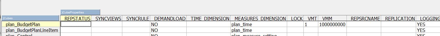

As a VMT and VMM settings, I gave VMT as 1 second and VMM as 1GB to see if it will create StargateView. But, I had the same error.
Maybe, I am missing a point to set up for creating Stargate View but I couldn't find any other information about it.
Thanks for the help.

- VMM of 1 may be too short - >3 is probably more suitable - have you tried slightly higher values again in PA?
