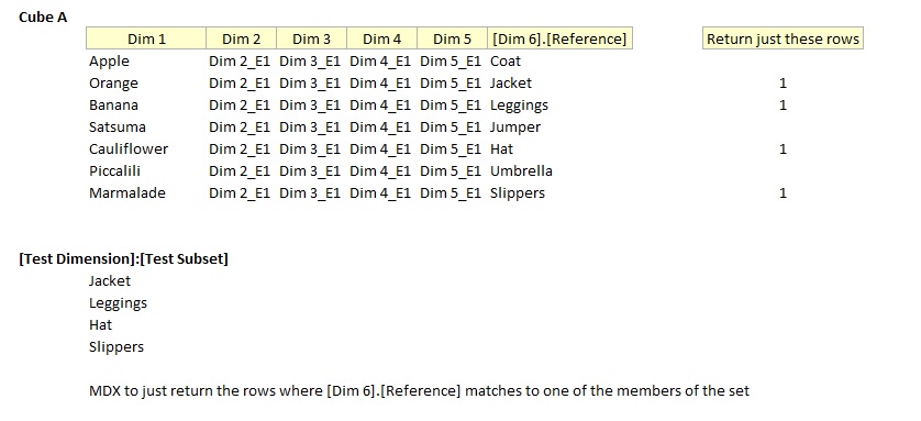

I've a tricky MDX view problem I am wrestling with.
Cube A contains a string measure, "Reference", this holds an element name from another dimension as a piece of data, let's call that dimension "Test Dimension". The dimension Test Dimension is not part of Cube A.
I can write a MDX view expression easy enough to give me all the tuples where Reference = A specific element in the Test Dimension.
What I need to do is scale this up to return all the tuples where the Reference = A Member of Test Dimension set.
My current approach is to loop over the Test Dimension set and execute the MDX View for each member of the set one by one. This is too slow as it takes ~20s to execute each query giving five hours for a complete pass over the subset of 1,000 members.
I'd like to execute a single MDX query, in order to do this I need to test the cell value against the enitre subset rather than one element at a time.

Re: MDX views, testing cell value against a subset
Posted: Tue Oct 12, 2021 11:26 am
by MarenC
Cant you create another measure in Cube A, which is rule based on the dimix of the other dim.
So, If( Dimix('Test Dimension', !reference) > 0,1,0);
And then build the view based on this value being a 1?
Posted: Tue Oct 12, 2021 11:37 am
by Steve Rowe
Hi Maren,
Yes, good idea and it had already dawned on me that this might be the best(?) approach, honest. Conveniently I already have a measure in the cube that is doing some flagging in a different direction so I can add a condition to that.
I'll need to build a dimension to match the subset but that's acceptable.
Posted: Thu Oct 14, 2021 9:03 pm
by Steve Rowe
Glad you're all having fun!
In the end I went with using a rule to calculate the filter flag with a simple Dimix of the cube value versus a dimension I built on the fly from the subset as per MarenCs suggestion at the top of the post. I then used the ruled filter flag to drive the MDX view.
This operated orders of magnitude faster, <10 mins rather than multiple hours. (Be careful with this timing as it is not like for like, the multiple hours is from looping over the subset calling the MDX repeatedly, so there is an overhead here from calling the TI and building all the views / subsets required to do the processing).
So whilst we can do clever things with MDX views now we have "MDXViewCreate" it was significantly quicker to write and execute using the tools native to TM1 or at least blending the two technologies.
