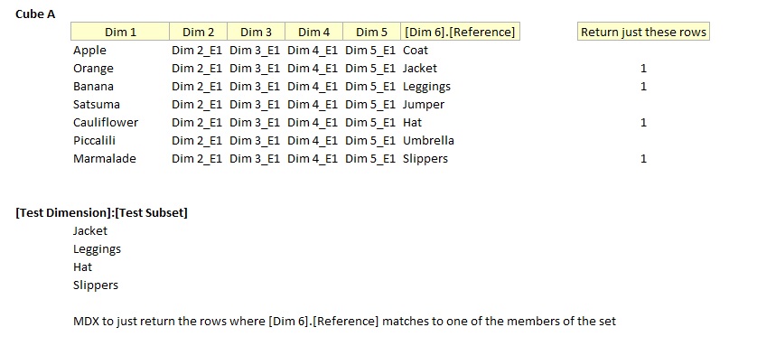

I've a tricky MDX view problem I am wrestling with.
Cube A contains a string measure, "Reference", this holds an element name from another dimension as a piece of data, let's call that dimension "Test Dimension". The dimension Test Dimension is not part of Cube A.
I can write a MDX view expression easy enough to give me all the tuples where Reference = A specific element in the Test Dimension.
What I need to do is scale this up to return all the tuples where the Reference = A Member of Test Dimension set.
My current approach is to loop over the Test Dimension set and execute the MDX View for each member of the set one by one. This is too slow as it takes ~20s to execute each query giving five hours for a complete pass over the subset of 1,000 members.
I'd like to execute a single MDX query, in order to do this I need to test the cell value against the enitre subset rather than one element at a time.
Option 1
Create a long concatenated string containing all the members of the subset and use the Instr MDX function to test for membership.
Should be fairly simple to write but I'm not expecting the Instr function to be fast and my test string will be about 13k characters long so this is going to bring it's own set of problems that will be hard / impossible to solve. Non-starter
Option 2
I could convert the cell value to a member using StrToMember and then test this against the set, so my filter expression on my view becomes
INTERSECT(StrToMember("[Test Dimension].[" + MDX to Return the cell value +"]),{[Test Dimension].[Test Subset]}).Count > 0
Seems to make sense on paper though getting the MDX written might be a challenge.
Option 3
Build another cube with Test Dimension in it as well as those in Cube A and then write a rule to perform the filter activity. A bit old school and I rather not build a cube just to support this, I should be able to handle this with MDX.
Anyone else have any bright ideas? Feels like I might be missing a trick somewhere...
TIA for any pointers.

Cant you create another measure in Cube A, which is rule based on the dimix of the other dim.
So, If( Dimix('Test Dimension', !reference) > 0,1,0);
And then build the view based on this value being a 1?

Hi Maren,
Yes, good idea and it had already dawned on me that this might be the best(?) approach, honest. Conveniently I already have a measure in the cube that is doing some flagging in a different direction so I can add a condition to that.
I'll need to build a dimension to match the subset but that's acceptable.

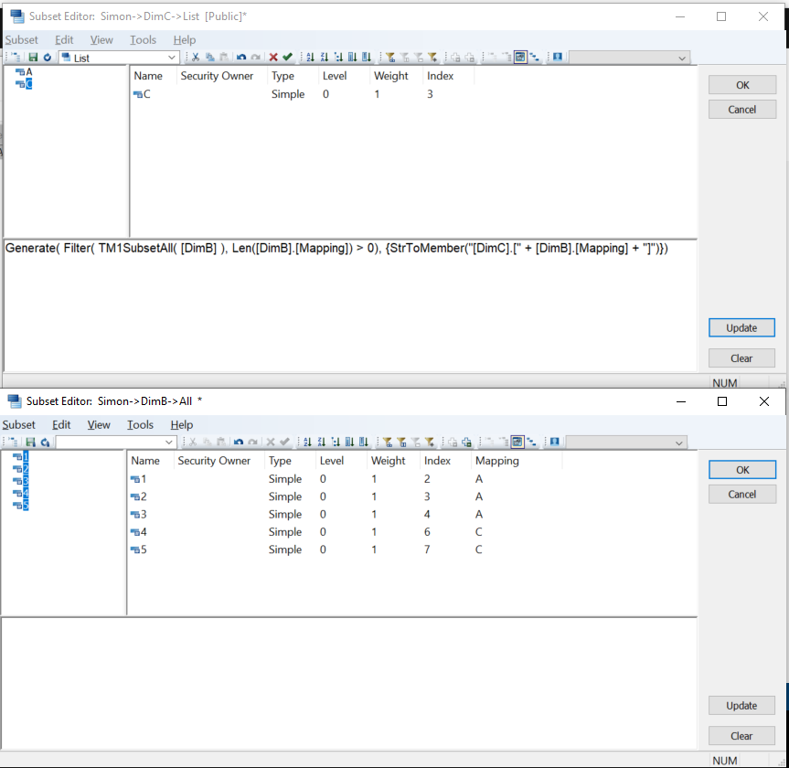

Hi Steve,
I've gone back on my idea and have gone with lotsaram's about using the generate. In the attachment I have:
a dimension (DIMC) with the elements A, B, C
a dimension (DIMB) with the elements 1,2,3,4,5
In DimB I have an string attribute called mapping which you can see has the following mapping
Element Mapping
1 A
2 A
3 A
4 C
5 C
So based on the above I'm looking to have a MDX Statement which brings back only A and C from DIMC, leaving B out.
For the MDX I have the following statement used within subset editor for dimension DIMC
Generate( Filter( TM1SubsetAll( [DimB] ), Len([DimB].[Mapping]) > 0), {StrToMember("[DimC].[" + [DimB].[Mapping] + "]")})
And the result is A and C is returned
Whilst I've used an attribute in my example you could do the same with a cube value. Whichever is your preference.

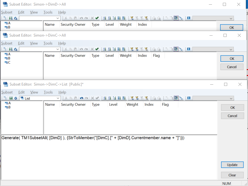

I've re-read the requirements, if you want to restrict the results of Dim6 based on the elements listed in the test dimension then you could use something like thisMarenC wrote: ↑Thu Oct 14, 2021 1:33 pm Hi,
Burnstripe,
where you say,
Can you please provide a specific example of this working, as I am struggling to imagine how this could be done in the context of this issue.Whilst I've used an attribute in my example you could do the same with a cube value. Whichever is your preference.
Maren
Generate( TM1SubsetAll( [DimD] ), {StrToMember("[DimC].[" + [DimD].Currentmember.name + "]")})
DimD, being your test dimension, and dimc being dim6 in this case.
In my example attached
DimD consists of 2 elements A, B
DIMC consists of 3 element A, B, C
And the statement executed in DIMC returns A, B as these are the only elements that exist in that dimension. If you wanted it based on a subset list you'd just need to change this section of the MDX above TM1SubsetAll( [DimD] )
- Example 20211014.PNG (99.31 KiB) Viewed 19159 times
