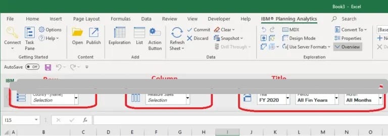

What I have seen in Pax 2.0.57, the dimension panel across the top, there is a grey banner covering top half of the dimension names right across the screen. When I try to read dimension names so I can make my selections, I can only see the bottom half of the names.

So I took this pic from Google and tried to sketch to how it looks officially.
The grey banner taking out half of the dimension names.
The resolutions depend on your monitor, though what we did was we moved away from recommended and chose 1920 x 1080 and then went back to recommended and then scale, we changed from 225% to 175% and played about to what suits.
and when we went back to PAx, it was sorted. So I think it worked more like a kick than anything else.
