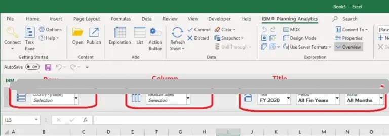

Not sure if this can be classed as a bug or a general.
What I have seen in Pax 2.0.57, the dimension panel across the top, there is a grey banner covering top half of the dimension names right across the screen. When I try to read dimension names so I can make my selections, I can only see the bottom half of the names.
I have tried uninstall and installs, doesnt make a difference, the settings are fine, and it's only one person that's impacted so far.
Does anyone have any ideas or anyone come across such issue?

So I took this pic from Google and tried to sketch to how it looks officially.
The grey banner taking out half of the dimension names.
The resolutions depend on your monitor, though what we did was we moved away from recommended and chose 1920 x 1080 and then went back to recommended and then scale, we changed from 225% to 175% and played about to what suits.
and when we went back to PAx, it was sorted. So I think it worked more like a kick than anything else.
