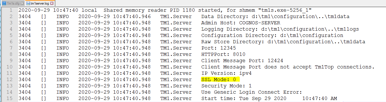

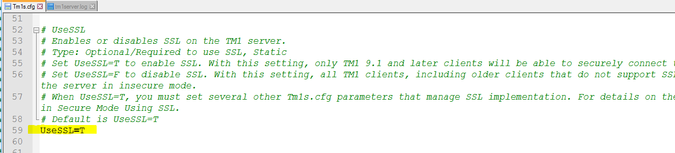

I was looking at a connection with the TM1 REST API to a customer's model. In the config file, we have UseSSL = T. When the TM1 server starts, it logs SSL Mode: 0. Does 0 mean True ? I haven't looked at it in any great detail but I found it weird.
UseSSL

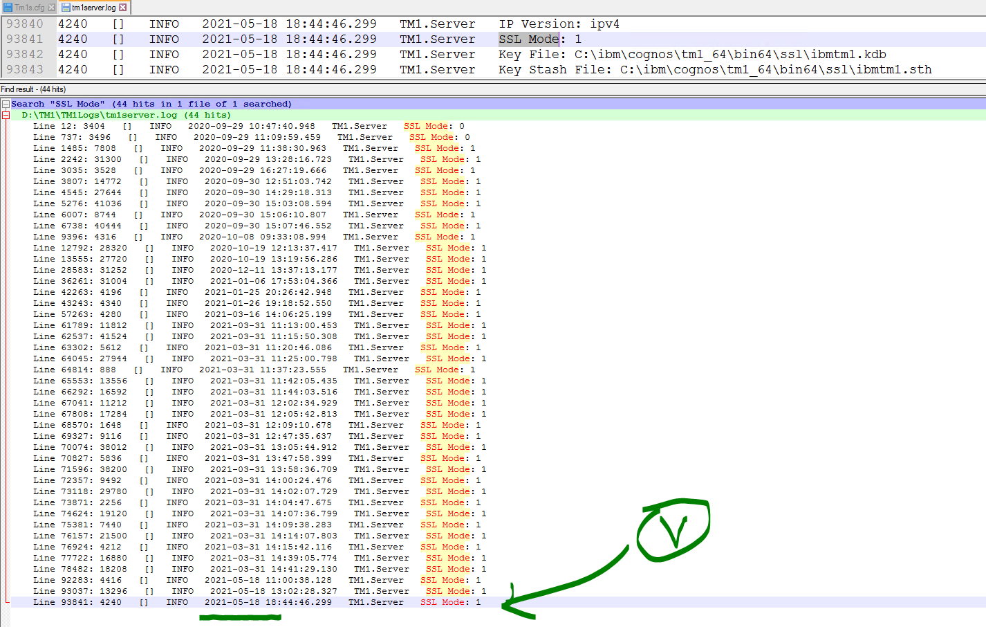

Seems fine on my side - What version are you trying on?
TM1 Build Number: 11.8.00500.12 (possibly PA 2.0.9.6)
Assuming you have double-checked that there is not another UseSSL statement in the file.
33244 [] INFO 2021-05-18 15:53:13.521 TM1.Server Logging Directory: c:\tm1 logs\XYZ
33244 [] INFO 2021-05-18 15:53:13.521 TM1.Server Configuration Directory: c:\tm1 data\XYZ
33244 [] INFO 2021-05-18 15:53:13.521 TM1.Server Raw Store Directory: c:\tm1 data\XYZ
33244 [] INFO 2021-05-18 15:53:13.521 TM1.Server Port: 27472
33244 [] INFO 2021-05-18 15:53:13.521 TM1.Server HTTPPort: 27474
33244 [] INFO 2021-05-18 15:53:13.521 TM1.Server Client Message Port: 27473
33244 [] INFO 2021-05-18 15:53:13.521 TM1.Server Client Message Port does not accept Tm1Top connections.
33244 [] INFO 2021-05-18 15:53:13.521 TM1.Server IP Version: ipv4
33244 [] INFO 2021-05-18 15:53:13.521 TM1.Server SSL Mode: 1
33244 [] INFO 2021-05-18 15:53:13.521 TM1.Server Key File: C:\Program Files\ibm\cognos\tm1_64\bin64\ssl\ibmtm1.kdb
33244 [] INFO 2021-05-18 15:53:13.521 TM1.Server Key Stash File: C:\Program Files\ibm\cognos\tm1_64\bin64\ssl\ibmtm1.sth
33244 [] INFO 2021-05-18 15:53:13.521 TM1.Server FIPS Operation Mode: 2
33244 [] INFO 2021-05-18 15:53:13.521 TM1.Server NIST SP800 131A Mode: 1
33244 [] INFO 2021-05-18 15:53:13.521 TM1.Server Certificate Authority: ibmtm1.arm
33244 [] INFO 2021-05-18 15:53:13.521 TM1.Server Client Export Server Certificate: 0
33244 [] INFO 2021-05-18 15:53:13.521 TM1.Server Security Mode: 1-

There's only 1 line with UseSSL in the cfg file.

It may sounds stupid but in the screenshot it shows log from 2020-09-29. Maybe they changed the UseSSL parameter recently ?
Re: UseSSL
That doesn't sound stupid at all ! You were right, thanks !
