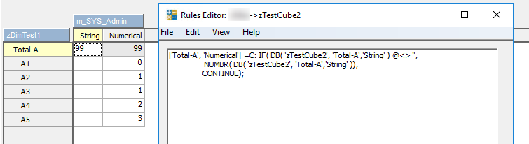

Emixam
- Posts: 158
- Joined: Tue May 21, 2019 3:33 pm
- Location: The Internet
Re: Prevent Consolidation Sums for an Element
I'm not sure what are the requirements or if it's the best way to do it but that's what you should do; change the element type to 'String'. You can also use the NUMBR function if you need to convert that string into a numerical value.
You simply cannot load/input numerical data into a C level element.
I suggest you to take a look at this post
Hope it helps !
- 2021-02-09_15h57_10.png (15.16 KiB) Viewed 4455 times
