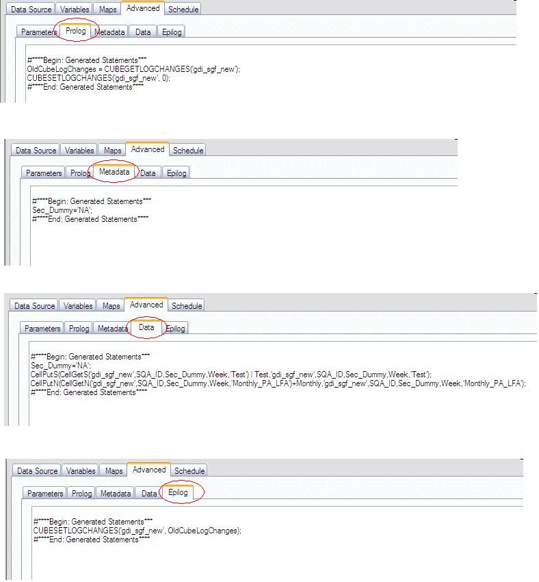

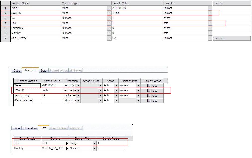

I had added a string measure corresponding to the actual numeric measure. During data mapping I was able to map the column to this value.
I had clicked on the advanced tabs to ensure code udation. Still I was getting the same error.
Michel : My measure dimension is the last dimension in the cube and I have changed the type of one element to string in this dimension
I am attaching my TI tabs for your reference. Let me know if I need to change anywhere.
Here 'Test' in my string measure, for which I have changed the type as 'String'. 'Public' is consolidation level element for which I am trying to do load this string value

- Steve Rowe
- Posts: 2467
Re: To load the data at consolidation level
Hi Can you post the code that is on advanced tabs too please?
sreesuku
- Posts: 47
- Joined: Wed Sep 14, 2011 7:45 am
- Version: PAW
- Excel Version: 2013
Hi Steve,
Please check the attached TI advanced tabs
- TM1_TI advanced
- TM1_T1_advanced.JPG (76.93 KiB) Viewed 14229 times
