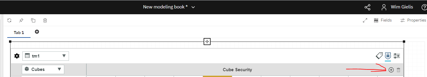

With a view on the }ClientGroups cube, I could not find it but I found it when editing the cube settings. For security you can add a new group:
This is in a cloud environment that was set up by IBM last week, so very recent.
Thanks a lot.

Burnstripe is correct, you can click on the "meatballs" menu next to Cubes, Edit Settings.
The widget added to the canvas will have Cube Security on columns and you will see a plus sign (Create user group) on the right below the security shield, next to the bin.

Thanks George, I also found it now, based on the explanations ! I was editing my previous post to reflect this information.
