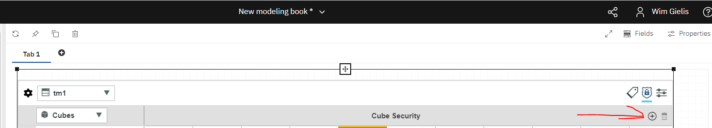

I'm pretty sure you can create groups from within paw/workspace. If I recall open a view on the control object }clientgroups scroll to the end of your groups and hopefully should see a little + symbol, click on this and add your group name.
If it's not here have right click on cubes and view the security properties and have a look for the + symbol on groups

burnstripe wrote: ↑Mon Feb 01, 2021 10:24 pm I'm pretty sure you can create groups from within paw/workspace. If I recall open a view on the control object }clientgroups scroll to the end of your groups and hopefully should see a little + symbol, click on this and add your group name.
Sorry can't be more specific, not got access to an environment this minute
With a view on the }ClientGroups cube, I could not find it but I found it when editing the cube settings. For security you can add a new group:
This is in a cloud environment that was set up by IBM last week, so very recent.
Thanks a lot.

HI Wim,
Burnstripe is correct, you can click on the "meatballs" menu next to Cubes, Edit Settings.
The widget added to the canvas will have Cube Security on columns and you will see a plus sign (Create user group) on the right below the security shield, next to the bin.
BR, George.
Re: New security groups in TM1 on cloud
Thanks George, I also found it now, based on the explanations ! I was editing my previous post to reflect this information.
