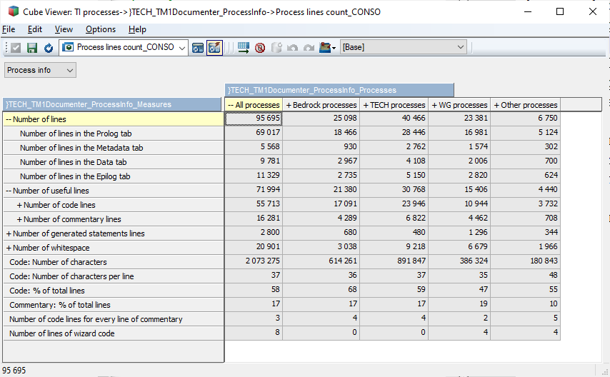

Below some statistics comparing Bedrock coding against my own TECHnical processes (used very much), other processes that are used less but still generic, and a couple of other ones. I'll leave the analysis for those of you interested. Yes, this cube is created with such a generic TECHnical process.
I posted a number of these TECHnical generic processes in the 'Tips and tricks' subforum here, although I tend to work on them and add improvements every once in a while.
Add to this about 46,000 lines of code in Excel VBA (not all TM1 related, though), 11,000 lines of code in Outlook VBA and 8,000 lines of code in AutoHotKey and you will understand that automation and using (reusable) code are important to me (in total about 120,000 lines of code).
