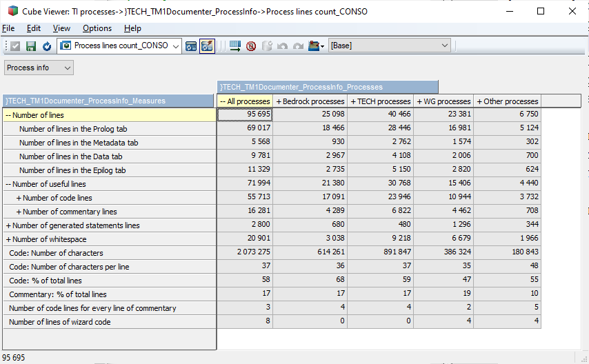

Below some statistics comparing Bedrock coding against my own TECHnical processes (used very much), other processes that are used less but still generic, and a couple of other ones. I'll leave the analysis for those of you interested. Yes, this cube is created with such a generic TECHnical process.
- 01.png (43.29 KiB) Viewed 1143822 times
