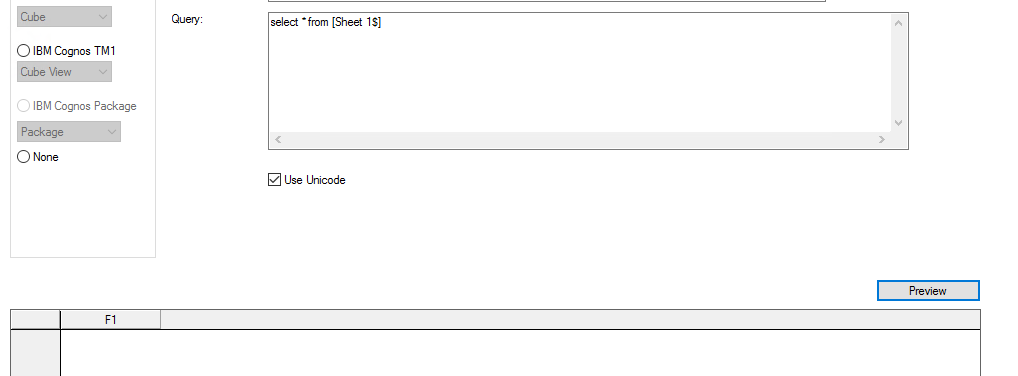

I'm trying to set ODBC connection to xlsx.
I get no results (there are in the Excel) just blank column F1
Roei
