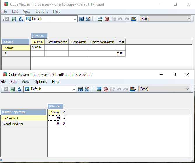

To use it, set IsDisabled to 1 in the }ClientProperties cube.
Note that you cannot disable a client that is part of the built-in Admin group. The property is ignored in that case.

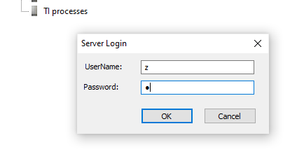

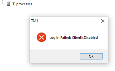

by Wim Gielis
For me it works. Here are screenshots.
PAL version 11.6.0.14

FWIW, Following Wim's process on PAL 2.0.9.2 (11.8.100.13) gives me the same results as Wim's i.e. Setting disabled to 1 blocks logins.
