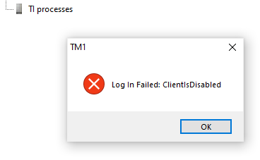

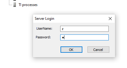

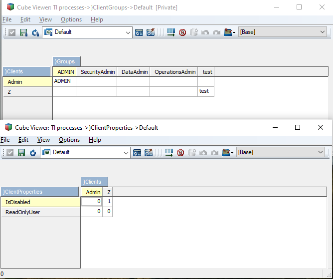

Re: PA 2.07 - }ClientProperties cube
For me it works. Here are screenshots.
PAL version 11.6.0.14
