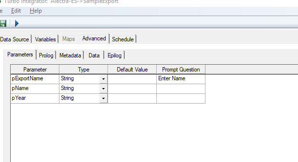

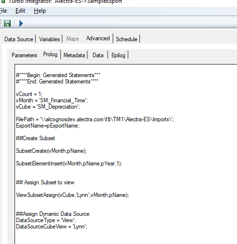

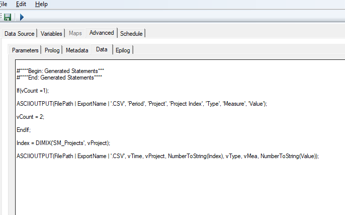

TI 2 (SampleExport) is the TI being called.
I have the sections of codes attached.
The view did get updated with subsets "lyn", "Tom", "mike" created in the SM_Financial_Time dimension.

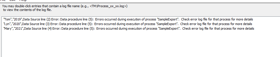

Here is the error messages...

lynnsong986 wrote: ↑Wed Nov 06, 2019 6:34 pm Here is the error messages...
You're in the process error messages for your calling process. In the server log, you should see individual ERROR entries for each of those process calls, you can then double-click on one of those to see the details. Alternatively, you can navigate to the folder where your log files are, sort by date modified, and look for any files with your 2nd TI process name in the file name. The process error log file will look something like "TM1ProcessError_20191106....SampleExport.log".
