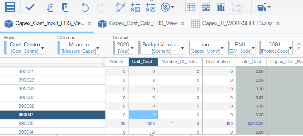

In any case, please provide screenshots of:
- the TI process
- the cube view, such that the name and the element references are visible
- the security setup

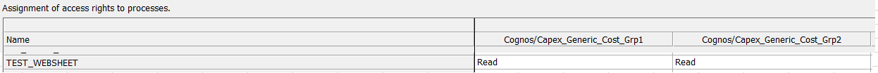

Please find the below script i was using in prolog section.
CellPutN (36,vsCube ,'2020' ,'RTB' ,'Capex' ,'0001' ,'Recharge' ,'P1' ,'Budget Version1' ,'Standard' ,'BM1' ,'Fittings - office layouts_Capex Template' ,'MFZ0977' ,'NRG615' ,'CL0003' ,'BA' ,'990011' ,'NA' ,'JAN' ,'Validity');
i can see the value in the cube when i execute it as an admin user.
and i have selected my data source as none for the TI. please find the attachment access given to the process TEST_WEBSHEET

The user is part of at least one of these groups ?
What does the user see if he does not see the 36 ?

You have 990011 in the CellPutN (is it a cost center ?) and your screenshot is showing something else. Please show the correct screenshot that matches the code, or change the code to match the screenshot.

Posted: Sun Nov 03, 2019 3:48 pm
by vikram.balaji16
Wim Gielis wrote: ↑Sun Nov 03, 2019 3:39 pm You have 990011 in the CellPutN (is it a cost center ?) and your screenshot is showing something else. Please show the correct screenshot that matches the code, or change the code to match the screenshot.
yes its a cost center, and the view is same as shown in the screen shot and for the validity and cost center i can see value 36 in tm1 web view.
where as i dont see the same data cube view for the base sand box.

Posted: Sun Nov 03, 2019 4:54 pm
by Wim Gielis
Please show a screenshot with 1 cell !
The exact cell that you target in the CellPutN.
A screenshot with the non admin user.

Posted: Sun Nov 03, 2019 5:10 pm
by vikram.balaji16
Wim Gielis wrote: ↑Sun Nov 03, 2019 4:54 pm Please show a screenshot with 1 cell !
How does it make difference.when all combination in the view is same .only the cost center is 990011 diff
Re: access control objects
Posted: Sun Nov 03, 2019 5:12 pm
by vikram.balaji16
In my architect cube view sand box is base and in the tm1 web view sand box is default. I can see data in sand box default, where as in sand box base I don't see the value
