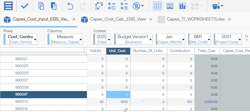

Re: access control objects
You don't have cell security applied by any chance ?
In any case, please provide screenshots of:
- the TI process
- the cube view, such that the name and the element references are visible
- the security setup

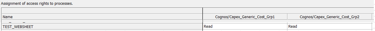

Please find the below script i was using in prolog section.
CellPutN (36,vsCube ,'2020' ,'RTB' ,'Capex' ,'0001' ,'Recharge' ,'P1' ,'Budget Version1' ,'Standard' ,'BM1' ,'Fittings - office layouts_Capex Template' ,'MFZ0977' ,'NRG615' ,'CL0003' ,'BA' ,'990011' ,'NA' ,'JAN' ,'Validity');
i can see the value in the cube when i execute it as an admin user.
and i have selected my data source as none for the TI. please find the attachment access given to the process TEST_WEBSHEET
The user is part of at least one of these groups ?
What does the user see if he does not see the 36 ?
Is the user using a sandbox ?

Wim Gielis wrote: ↑Sun Nov 03, 2019 12:38 pm The user is part of at least one of these groups ?
yes he is part of one of the group.
You have 990011 in the CellPutN (is it a cost center ?) and your screenshot is showing something else. Please show the correct screenshot that matches the code, or change the code to match the screenshot.

Post by vikram.balaji16 »
Wim Gielis wrote: ↑Sun Nov 03, 2019 3:39 pm You have 990011 in the CellPutN (is it a cost center ?) and your screenshot is showing something else. Please show the correct screenshot that matches the code, or change the code to match the screenshot.
yes its a cost center, and the view is same as shown in the screen shot and for the validity and cost center i can see value 36 in tm1 web view.
where as i dont see the same data cube view for the base sand box.
Please show a screenshot with 1 cell !
The exact cell that you target in the CellPutN.
A screenshot with the non admin user.
Wim Gielis wrote: ↑Sun Nov 03, 2019 4:54 pm Please show a screenshot with 1 cell !
How does it make difference.when all combination in the view is same .only the cost center is 990011 diff
In my architect cube view sand box is base and in the tm1 web view sand box is default. I can see data in sand box default, where as in sand box base I don't see the value
