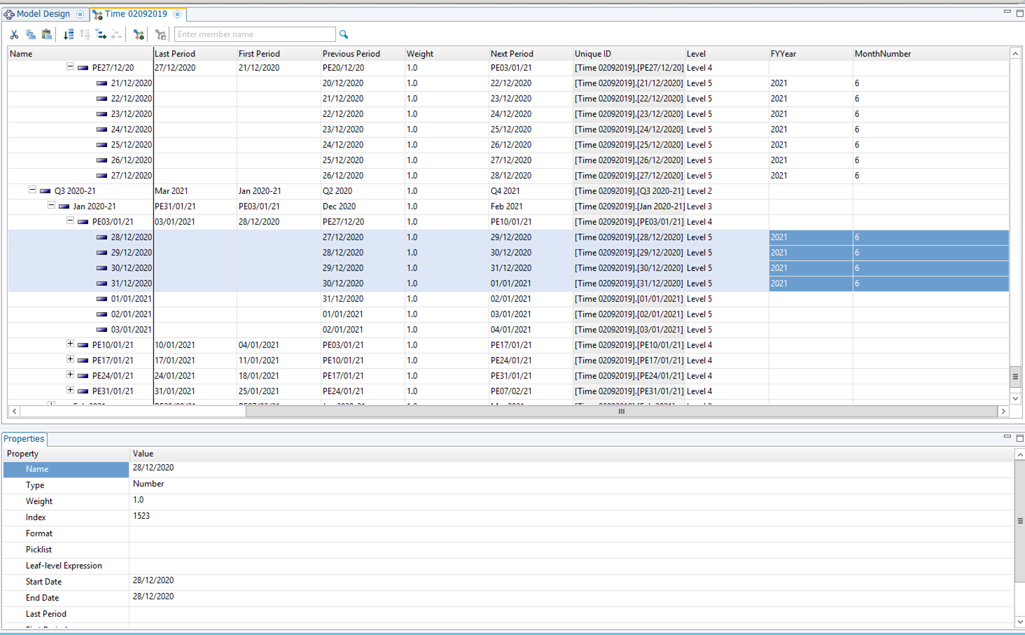

Is there a way that I can mass edit the attributes of a dimension after the dimension been created already?
How does you dimension look like? Could you post a screenshot?

The below is my dimension screen shot.
As you can see, I am at the moment, manually adding the year number and month number to the 2 newly add attributes of the dimension on day level.
Just wandering , if there is a fast way / automatic way to do this process, maybe by using rules or formulas?
Thanks a lot.
W

You could add an alias to your existing Month dimension to store 01, 02 etc. for Jan, Feb and so on.
On your Time dimension add a new attribute for Month and a rule to derive the Month (Jan, Feb...) by parsing the month from the element (subst first 2 characters) against your month dimension.
You may want to also create a Year element and populate it by rule using a subst on characters 7-10
You will need to consider rules for your leaf levels as well as each other level in the various hierarchies.

by orlando
WayneBo wrote: Fri Sep 27, 2019 12:33 pm Hi Orlando:
yep - there is.
Rule or TI.
If you're using a Rule - you don't have to worry about new elements
somethink like that should work - https://exploringtm1.com/subst-tm1-function-use-syntax/
Year = SUBST(!DimensionWithDay, 7, 4);
for the day u the same
if you don't like a rule you can use SUSBT in an TI.
best regards and have a nice weekend
orlando
