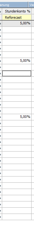

Edit:
Let me show you some screens, may its easier to understand what i mean. i think its very basic what i ask :)
This is how the cube was before i added the "UNDEFVALS" to the Rule:
Stundenkonto without UNDEFVALS.PNG (5.44 KiB) Viewed 13738 times
This is with:
Stundenkonto UNDEFVALS.PNG (4.56 KiB) Viewed 13738 times
Do i really have to add "0" manually in every cell? (Its not just the few one on the screen)
