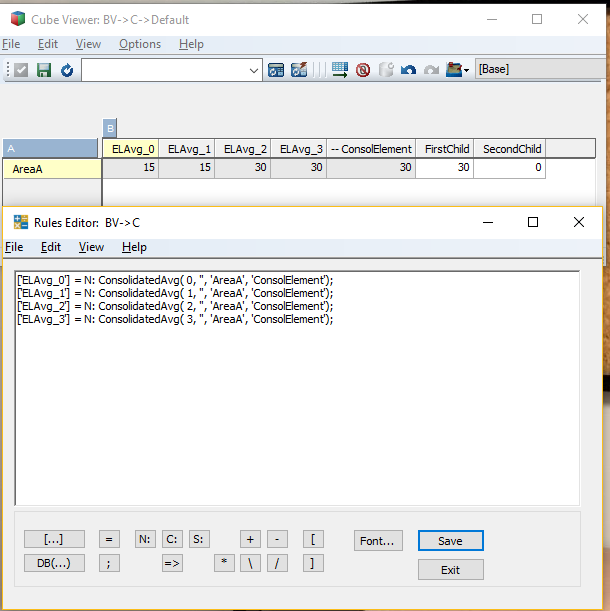

Re: Flag value in consolidatedavg function
Hello Maren,
For me it works fine. PAL 2.0.7
- 01.png (40.92 KiB) Viewed 10711 times
Hi Wim,
thanks for taking the time to respond to this,
Here are my screen prints:
First with the rule as you have it:
Then with undefvals in the rule:
Then with Undefvals commented out:
regards, Maren
First test without undefvals like me.
Hi Wim,
That is what I did, if you look at my first screen print in the comment above I first had the rule just as you had it, i.e. without undefvals.
The second and third images then show what happens when I use undefvals
regards, Maren
