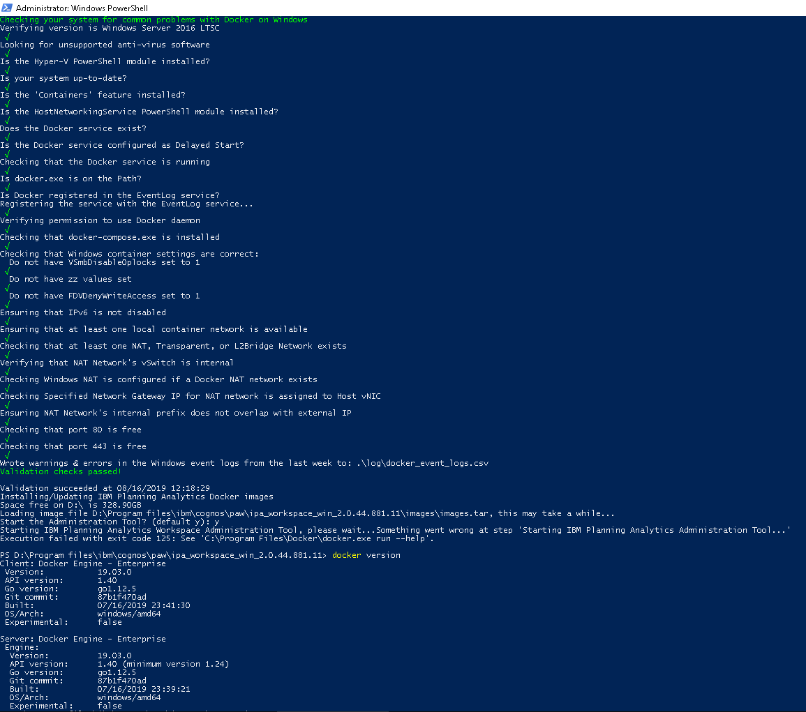

I am facing an issue with the latest update of Planning Analytics Workspace local v2.0.44 in windows. We earlier had 2.0.43 installed and running. After the new version was released I tried to install the new version. To my surprise, after validating all the checks (VALIDATE_HOST="true"), and creating all the new images, it did not update any container. The Admin tool failed to run showing the following message,
Starting IBM Planning Analytics Workspace Administration Tool, please wait...Something went wrong at step 'Starting IBM Planning Analytics Workspace Administration Too...' Execution failed with exit code 125: See C:\Program Files\Docker\docker.exe run --help'.

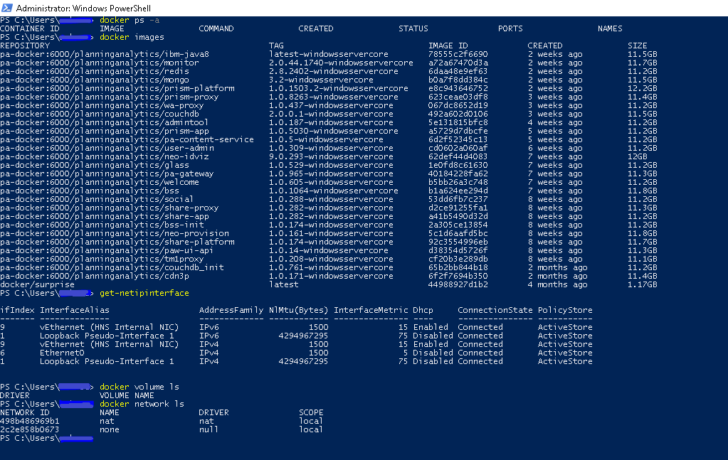

I tried with a fresh docker install with nothing existing, docker ps -a shows no containers. docker images command shows all the 2.0.44 images created.

When we usually install PAW, there are around 10~12 containers gets created. While installing PAW 2.0.44, after the images are created, it is not creating any container. docker ps -a shows nothing but header. Attaching the screenshots during and after installation,
PS. I tried running scripts/pws.ps1 but no luck. No volumes are created as well.
