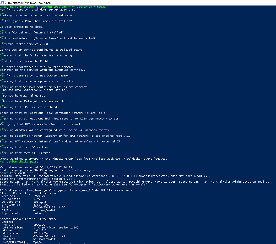

I am facing an issue with the latest update of Planning Analytics Workspace local v2.0.44 in windows. We earlier had 2.0.43 installed and running. After the new version was released I tried to install the new version. To my surprise, after validating all the checks (VALIDATE_HOST="true"), and creating all the new images, it did not update any container. The Admin tool failed to run showing the following message,
Starting IBM Planning Analytics Workspace Administration Tool, please wait...Something went wrong at step 'Starting IBM Planning Analytics Workspace Administration Too...' Execution failed with exit code 125: See C:\Program Files\Docker\docker.exe run --help'.
The exit code 125 is very generic and it means run command itself failed.
I tried with existing install (2.0.43) and when started the existing containers, checking the version from PAW URL was showing 2.0.43.
I tried with a fresh docker install with nothing existing, docker ps -a shows no containers. docker images command shows all the 2.0.44 images created.
Tested on Docker 18.09.2 , 19.03.0. No Antivirus installed. All validation checks from Start.ps1 were successful. We are using Windows Server 2016 Standard. Data root for docker is 'D:\Program Files\Docker' (daemon.json is only having this config).

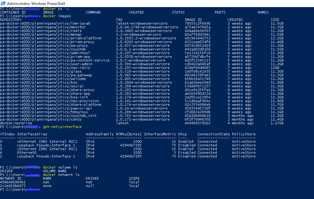

When we usually install PAW, there are around 10~12 containers gets created. While installing PAW 2.0.44, after the images are created, it is not creating any container. docker ps -a shows nothing but header. Attaching the screenshots during and after installation,
PS. I tried running scripts/pws.ps1 but no luck. No volumes are created as well.

Thank you for pointing out the correct area dr.nybble. It seems that the containers/volumes are not being created automatically for some reason. I was trying scripts/paw.ps1 start earlier which obviously failed as no containers were available.
Running scripts/paw.ps1 without parameters created all the volumes and containers. now PAW works fine. But admin tool is still an issue as you pointed out earlier.
