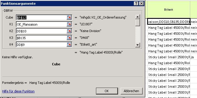

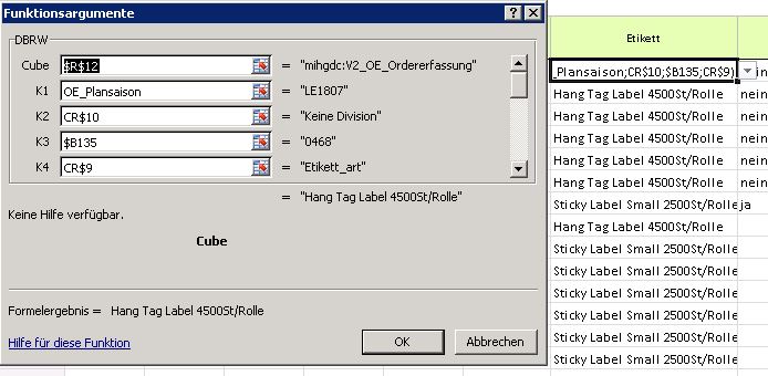

yes, it's exactly the same cell. Here is the cell with the Dropdown:
and here is the cell without:
Luckily the cube has only 4 Dimensions so it is all shown in the window for function-arguments. Also the Sheets looks very similiar but in fact they are different Sheets.

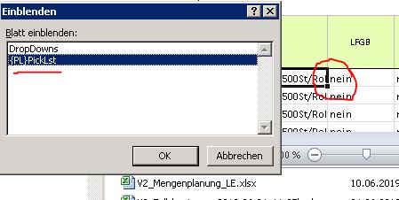

Posted: Fri Jul 26, 2019 10:12 am
by Mark RMBC
is there an hidden sheet called picklist in the one that isn't working?
Re: Piclists in Perspectives
Posted: Fri Jul 26, 2019 12:22 pm
by Willi
Yes, it is.
