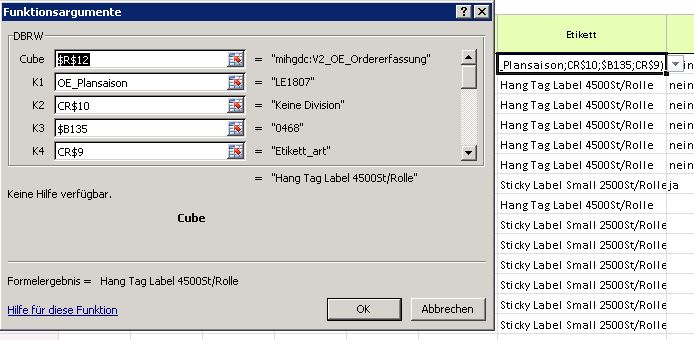

yes, it's exactly the same cell. Here is the cell with the Dropdown:

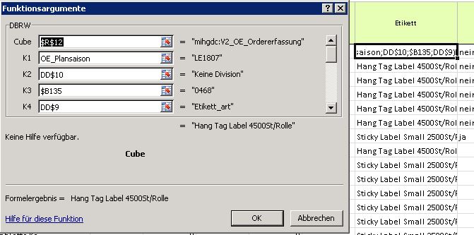

and here is the cell without:
Luckily the cube has only 4 Dimensions so it is all shown in the window for function-arguments. Also the Sheets looks very similiar but in fact they are different Sheets.

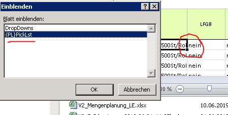

is there an hidden sheet called picklist in the one that isn't working?
Willi
Posts: 151
Joined: Mon Oct 07, 2013 11:51 am
Version: 9.5.2
Re: Piclists in Perspectives
Post by Willi »
Yes, it is.
