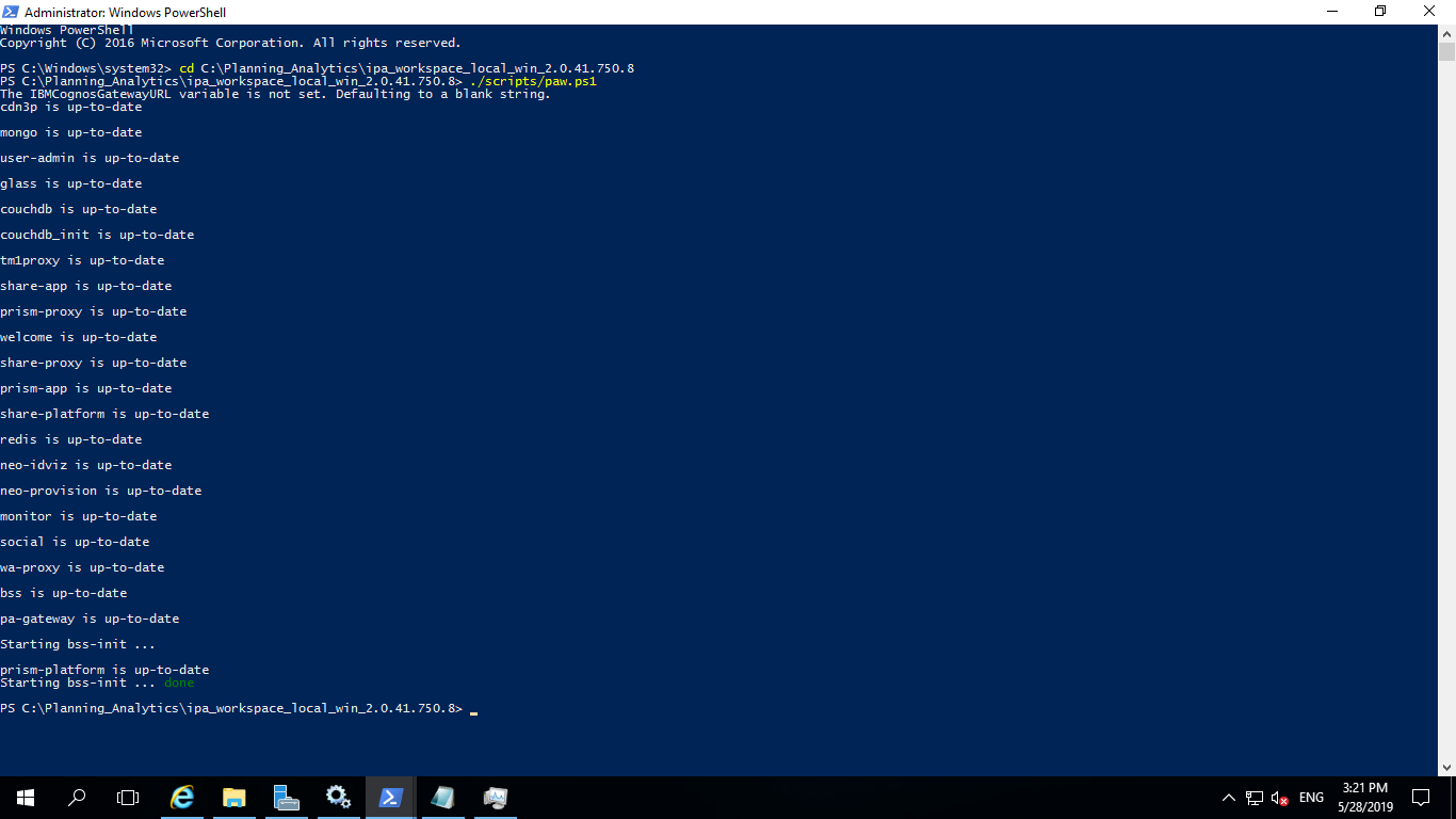

Below is a screenshot of the PAW script
PAW Scripts.png (46.83 KiB) Viewed 14194 times
