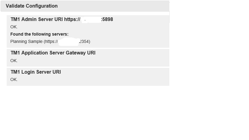

Hi dr.nybble
So I have confirmed that the "IBM Planning Analytics Administration Agent" service is running - I was running all along apparently.
I added the IPAddressV4 parameter onto the .cfg file (the AdminHost and IPAddressV4 parameters are the same)
But after restarting the TM1 Service, TM1 Admin Server, as well as the PAW Admin Tool, I go the following error.
"pa-gateway’s server IP address could not be found"
This is after successfully validating the configuration on PAW Admin tool
PAW Admin Validation.png (11.3 KiB) Viewed 14188 times

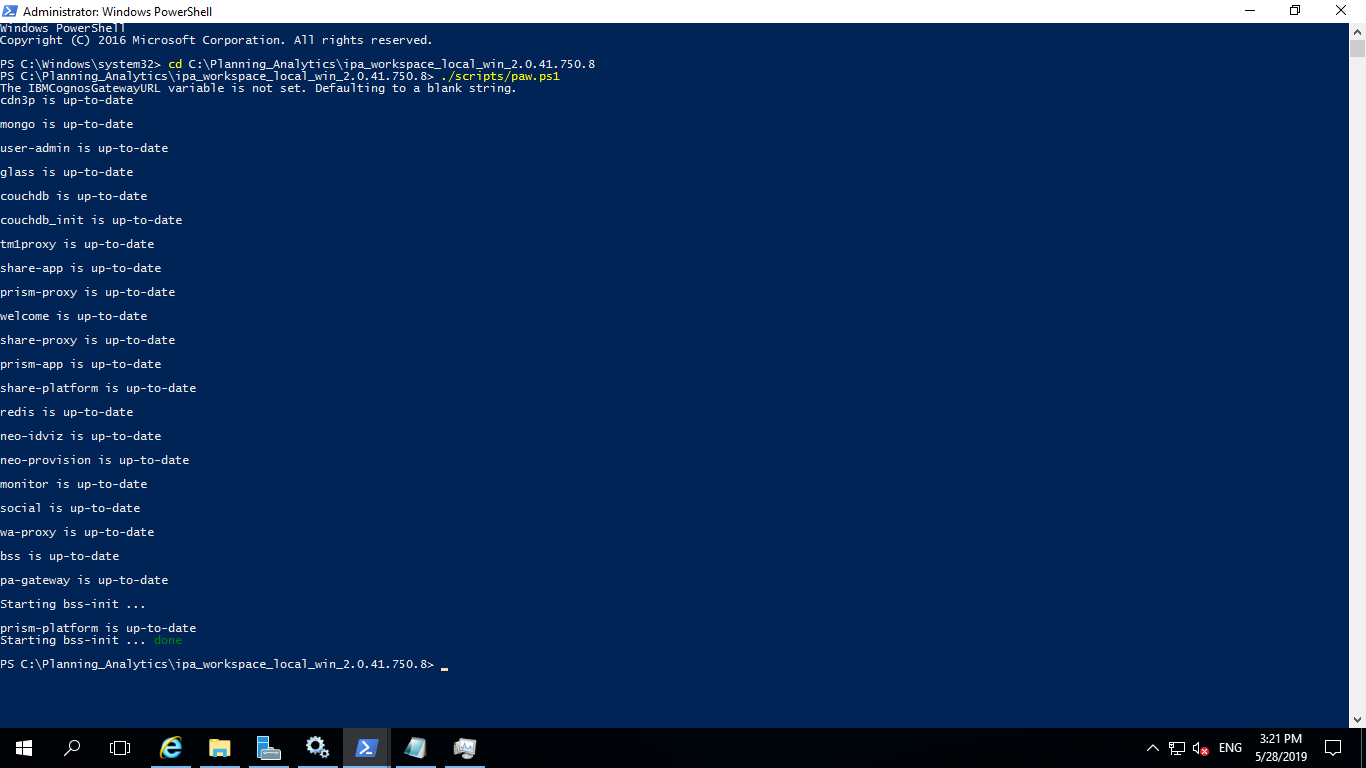

Below is a screenshot of the PAW script
PAW Scripts.png (46.83 KiB) Viewed 14188 times
