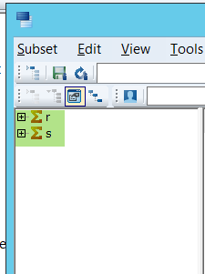

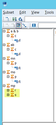

Example Dimension has two consolidations without children:
Test2 hierarchy.png (13.97 KiB) Viewed 18253 times
This MDX code produces as set of the consolidations without children:
FILTER(EXCEPT(TM1SUBSETALL( [test2] ), TM1FILTERBYLEVEL( TM1SUBSETALL( [test2]), 0)),
    TM1TUPLESIZE( ([test2].currentmember.children).ITEM(0)) = 0)
Save the subset and expose the subset with REST API.

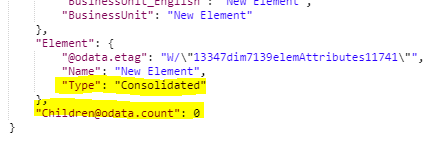

This should do the trick:
/api/v1/Dimensions('plan_business_unit')/Hierarchies('plan_business_unit')/Members?$select=Name&$expand=Element($select=Type),Children/$count&$filter=Element/Type eq 3 and Children/$count eq 0
