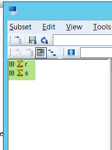

Example Dimension has two consolidations without children:
Test2 hierarchy.png (13.97 KiB) Viewed 18232 times
This MDX code produces as set of the consolidations without children:
FILTER(EXCEPT(TM1SUBSETALL( [test2] ), TM1FILTERBYLEVEL( TM1SUBSETALL( [test2]), 0)),
    TM1TUPLESIZE( ([test2].currentmember.children).ITEM(0)) = 0)
Save the subset and expose the subset with REST API.
