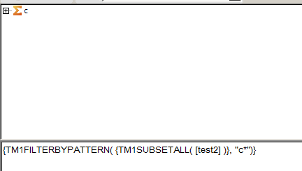

The TM1FILTERBYPATTERN function here gives me the right result after adding asterisk in it but still not give me right result after combining with TM1DRILLDOWNMEMBER funtion.
Literally, the following two are the same things,
{ [test2].[c] }
But this gives me the right result all the time.
{TM1FILTERBYPATTERN( {TM1SUBSETALL( [test2] )}, "c*")}
Anyway, it is not a big issue and there are a number of ways to avoid it. I am just curious to know why.

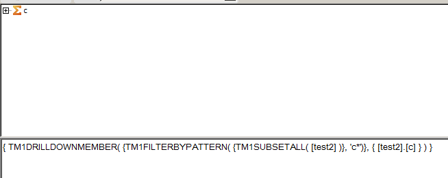

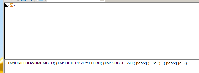

I think I found the root cause of this different behavior. Forget about the ampersand in the parent.
It is just collapsed/expanded status of [c] in the dimension that impacts the different behavior of TM1FILTERBYPATTERN function.
In multiple rollups for [c] in the dimension, TM1FILTERBYPATTERN function just look up for the first appearance of the [c], if that [c] is expanded, then TM1DRILLDOWNMEMBER function can show the expanded status as well. if it is collapsed, then collapsed also.
See the difference below,
0. The whole structure now,
1. After show all, the first [c] in [ba] is collapsed and the second [c] is expanded.

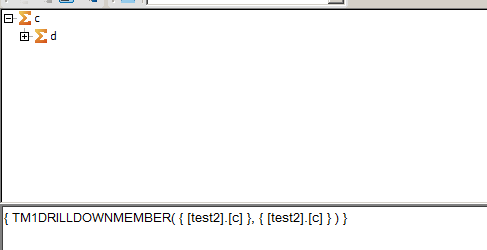

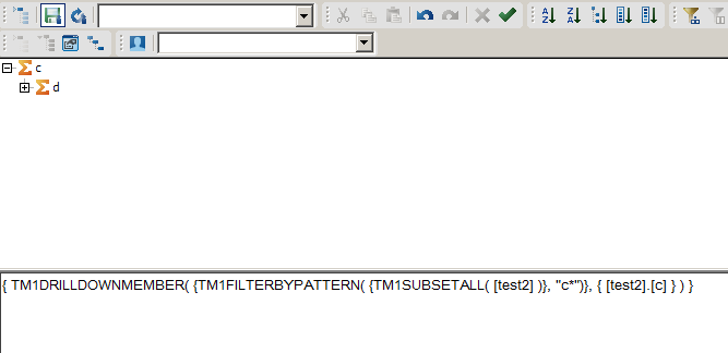

2. I change the status in the dimension editor to let the first [c] in [ba] is expanded and the second [c] is collapsed for show all button.
