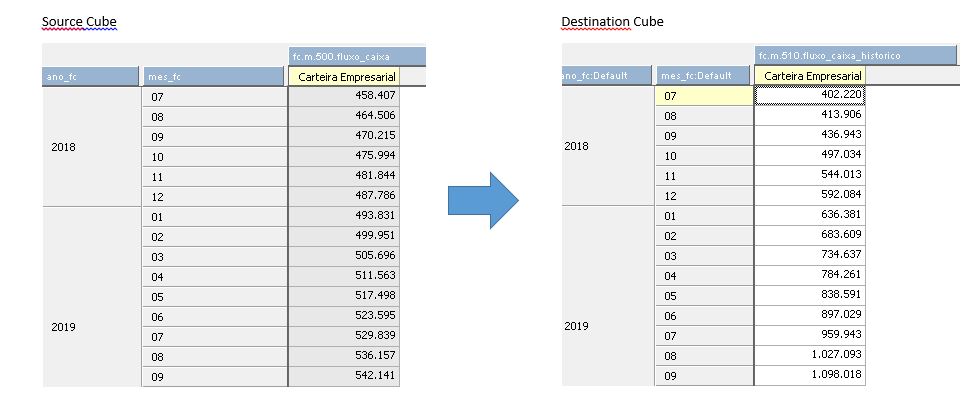

I have a process to copy data from one cube (calculated version) to another one (historical data), but the problem is when I do this copy using a view from the first cube as source, the value that is copied is diferent. This could be a feeder problem?
I checked all values using check and trace feeders and everything seems to been fed correctly.
Find below screenshot between source and destionation cube:

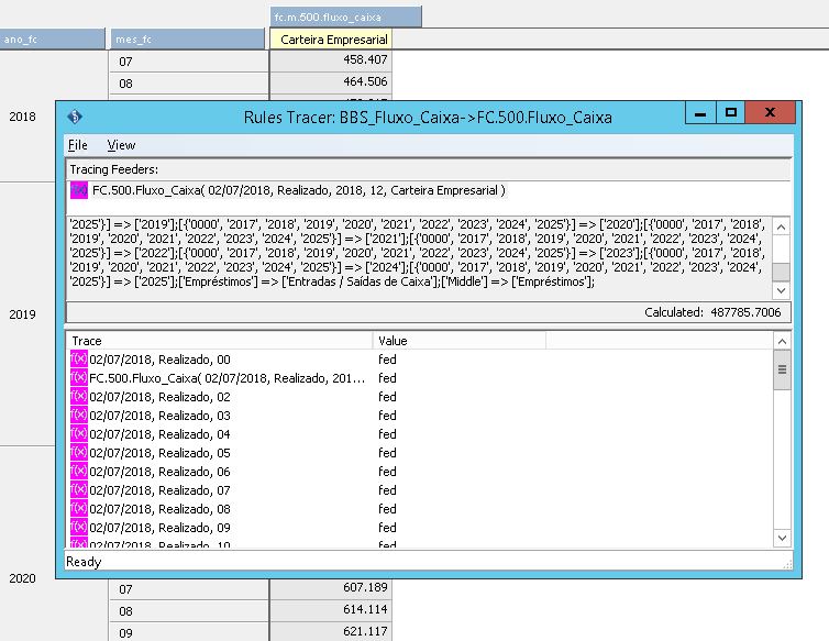

Now another one showing that values on source cube are fed:
What could be wrong on this case?
