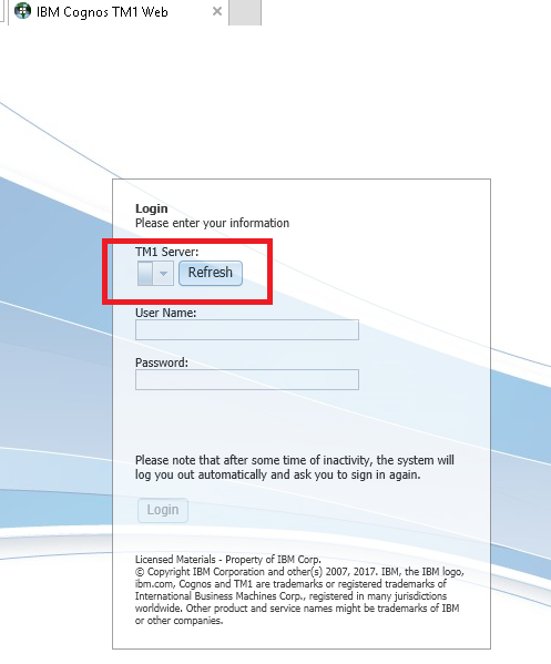

I’ve a problem about TM1 Web .It does not display any TM1 service but available both Architect and Perspective. Any suggestion pleases advice.
• TM1 version 10.2.2 64 bit Fix pack 7
• WINDOW server 2016

jim wood wrote: ↑Fri Jun 29, 2018 11:50 am Have you set the admin host in web?
Thank you for advice. Yes I had set Admin Host name, IP or blank values but it does not show any service yet. However I can solve this case as below
1. Uninstall and Install again
2. Update SSL in ..\bin64\ssl and \bin\ssl
3. DONOT update SSL in webapps\pmpsvc\WEB-INF\bin64 --> I think this step because in another server I does not update.
4. Update Fix pack
5. Any configuration values is default

Elessar wrote: ↑Fri Jun 29, 2018 12:36 pm Which link are you using? "localhost:port/tm1web" or "FQDN:port/tm1web"?
Thank you for advice. Both localhost and IP/Server Name values but it does not show any service
3. DONOT update SSL in webapps\pmpsvc\WEB-INF\bin64 --> I think this step because in another server I does not updated.
4. Update Fix pack
