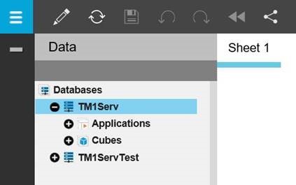

I encounter an issue with PAW, being that in the navigation pane for Applications, Cubes, Dimensions, Processes,
Dimensions and Processes and control objects are missing:
only applications and cubes.jpg (15.88 KiB) Viewed 14271 times
Is this a setting that we can/should change, or more likely to be an installation issue ?

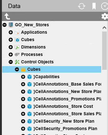

Could be permissions or version - I am logged in as Admin on PAW 2.0.4 running on Windows 2016 and see:
Further down are the Control Processes.

by Wim Gielis
I have the same when I log on to PAW systems in the cloud (IBM cloud concierge). Then I see all nodes.
In this instance, the sceenshot is as shown.
I will get back to you Edward when I get the information, thanks.

Re: PAW - missing dimensions and processes
Posted: Thu May 17, 2018 8:25 pm
by Wim Gielis
It’s solved. George is right, the first user created becomes administrator. Apparently the customer had deleted this first user, and then the administrator role goes to the user that was created second. The user that was used for the screenshot did not have the administrator rights. Thanks to the both of you.
