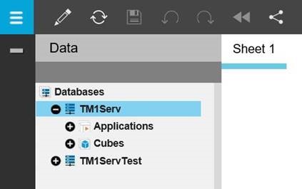

I encounter an issue with PAW, being that in the navigation pane for Applications, Cubes, Dimensions, Processes,
Dimensions and Processes and control objects are missing:
only applications and cubes.jpg (15.88 KiB) Viewed 14266 times
Is this a setting that we can/should change, or more likely to be an installation issue ?
Many thanks,
Wim

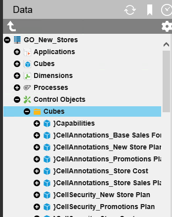

Could be permissions or version - I am logged in as Admin on PAW 2.0.4 running on Windows 2016 and see:
Further down are the Control Processes.
BR, George.
Re: PAW - missing dimensions and processes
I have the same when I log on to PAW systems in the cloud (IBM cloud concierge). Then I see all nodes.
In this instance, the sceenshot is as shown.
I will get back to you Edward when I get the information, thanks.
