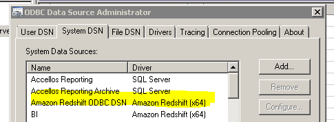

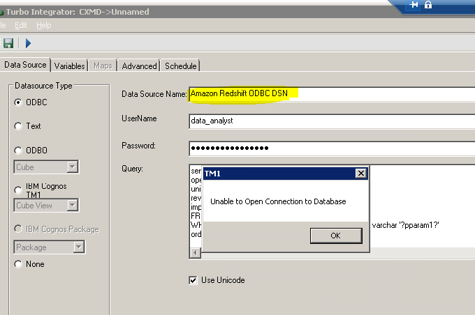

Currently, I have an issue where TI unable to open ODBC connection to Amazon Redshift. This connection also worked well initially and unable connect now. (image 1).
Driver used is Amazon Redshift (x64) (image 3).

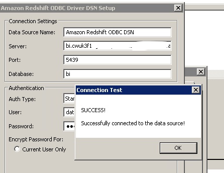

However, connection test is successful on Windows ODBC Data Source Administrator (image 2). ALl other ODBC connections work well with TM1.

Are you sure your password in TI is right?

Yes, the password is correct. The process ran for last 5 days successfully and now it cannot connect.
It has the same login details as 'ODBC data source Administrator'.

Thush_CMB:
You say it ran successfully previously?
Perhaps an application-based security/firewall change on the server?
Is the TM1 Service tied to a network account? Could that network account password have been changed but TM1 instance was never cycled to re-load it's authentication? i.e. Lost its ability to use domain services?
...Just a few thoughts.....

blackhawk wrote: ↑Fri Feb 23, 2018 7:03 pm Thush_CMB:
As far as I remember access to AWS RS resources are controlled by IAM. Perhaps check whether data_analyst is assigned to a correct IAM role(s).
