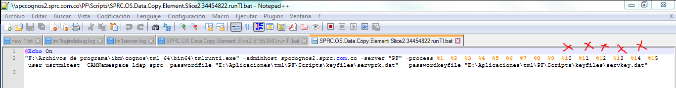

Yes you're right. I think found that Tm1RunTi only reads until 9 parameters and my process has 15...
i confirmed this adding a LogOut instruction in the prolog of child process, the i realize that parameters from 10 to 15 was in blank:
12768   [1d4a]   INFO   2017-09-22 10:01:11.212   TM1.TILogOutput   OS.Data.Copy.Element.Slice2-pElementSource=Real-pElementTarget=RecalculopCube=R.Estado.Financiero-pDimension=R_Version-pSliceDimension=Periodo-pSliceFirstElement=2017.06-pSliceLastElement=2017.06-pSkipZero=-pSkipConsolidated=-pSkipRules=-pClearDestOnly=-pDimension2=-pElement2=-pElement2b=
[img]
BatFile_For_Tm1RunTi
[img]
i changed the child process to ask only for 8 parameters and it is working fine now. Even though Tm1Server.Log never show me an execution error before...

First of all, i want to correct my last post...
RunTi can send to the .Bat File as many parameters as the TI Process has, but the CMD batch script only can read until 9 parameters. There's some ways to get more than 9 parameters as descripted in the link below, but i didn't consider this so that's why my process always faild as i show you in my last post. (I realized it until i put the LogOutput instruction) and i decided edit the TI process to ask only for 9 parameters... i was easy for me...
https://stackoverflow.com/questions/832 ... -batch-scr
On the other hand,
you run over 15 process on one thread?
maybe you should run one process by one user thread?
yes, i run over 15 processes but all in Batch, i mean i am sending each one as a new connection with RunTi...
