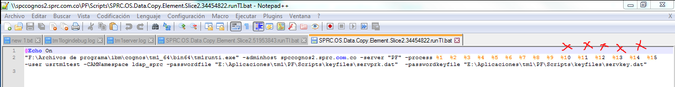

Yes you're right. I think found that Tm1RunTi only reads until 9 parameters and my process has 15...
i confirmed this adding a LogOut instruction in the prolog of child process, the i realize that parameters from 10 to 15 was in blank:
12768   [1d4a]   INFO   2017-09-22 10:01:11.212   TM1.TILogOutput   OS.Data.Copy.Element.Slice2-pElementSource=Real-pElementTarget=RecalculopCube=R.Estado.Financiero-pDimension=R_Version-pSliceDimension=Periodo-pSliceFirstElement=2017.06-pSliceLastElement=2017.06-pSkipZero=-pSkipConsolidated=-pSkipRules=-pClearDestOnly=-pDimension2=-pElement2=-pElement2b=
[img]
BatFile_For_Tm1RunTi
[img]
i changed the child process to ask only for 8 parameters and it is working fine now. Even though Tm1Server.Log never show me an execution error before...

First of all, i want to correct my last post...
RunTi can send to the .Bat File as many parameters as the TI Process has, but the CMD batch script only can read until 9 parameters. There's some ways to get more than 9 parameters as descripted in the link below, but i didn't consider this so that's why my process always faild as i show you in my last post. (I realized it until i put the LogOutput instruction) and i decided edit the TI process to ask only for 9 parameters... i was easy for me...
https://stackoverflow.com/questions/832 ... -batch-scr
On the other hand,
you run over 15 process on one thread?
maybe you should run one process by one user thread?
yes, i run over 15 processes but all in Batch, i mean i am sending each one as a new connection with RunTi...

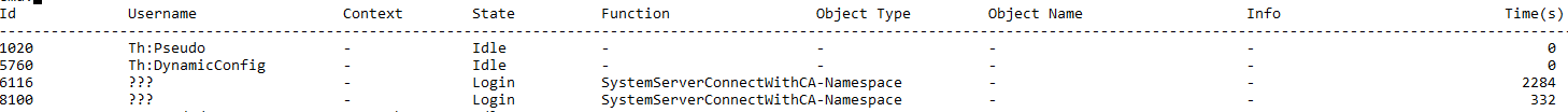

I have a similar problem in executing paralel processes via RunTI with the same CAM user.
9372   [23e]   DEBUG   2019-06-21 17:58:08.023   TM1.Lock.Exception   Contention encountered attempting to acquire lock (0x000000000BEA1C10) on object [Client "CAMID("CognosEx:u:uid=myrunti_user")", addr=0x0000000009BF5E10, index=R-4440] in READONLY mode at ..\tm1_r7s\TM1ClientImpl.cpp:1479 during function 'SystemServerConnectWithCAMNamespace'. Entering wait state 'IXC'.
Blocked by the following 1 thread:
Thread 8992 holds the lock in IX mode
CAM user authentication keeps causing contention lock and not able to login via RunTI.
Do you know if this solution is resolved in any version? This issue is happening in PA 2.0.5 now.

tm1runTI doesnt like \ in the parameters. Sometimes you have to change to double backslash. That might cause your missing parameters...
