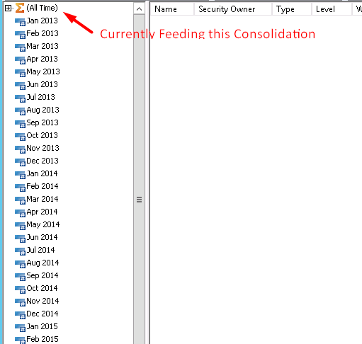

Currently I'm feeding the (All Time) roll up as my leaf elements that are being populated with the consolidated values will be fed.

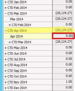

Yes the elements you see with the CTD are all consolidated.
Basically it means "cumulative to date" and each Parent has the preceding Parent + the month as children.
So as an example if you wanted to look at a cumulative balance at December 2016 my Time dimension aggregates in a hierarchy all the values from the beginning of time into this Parent.
Source Cube = Rule pulling from element CTD Apr 2014
Target Cube = Rule populating leaf element Apr 2014
If I feed from leaf elements the result will be unfed since there is a 0 value in Apr 2014 in my source cube.

I would use TI to create consolidations in the target cube; for each month there should be a (wisely named) consolidation containing that month AND all the future months. Then you can feed from an n-level element to the consolidated element (containing all future n-level months). You do not need to feed to '(All Time)' because then a month also feeds a month in the past. What's the benefit ?

At least the feeder to (All Time) should be replaced with a feeder to 'a month and its months in the future' consolidation.
